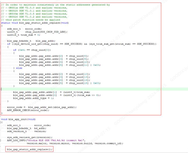

修复办法可在升级新版SDK后,在ble stack初始化完成后应用以下patch,使用方法见下图
// In order to maintain consistency in the static addresses generated by
// - GR551x SDK V2.0.0 and earlier versions,
// - GR5525 SDK V1.0.1 and earlier versions,
// - GR533x SDK V1.0.5 and earlier versions,
// - GR5526 SDK V1.0.2 and earlier versions,
// this patch function needs be applied
static void ble_gap_static_addr_replace(void)
sdk_err_t error_code;
uint8_t chip_uuid[SYS_CHIP_UID_LEN];
uint16_t trim_sum = 0;
ble_gap_bdaddr_t ble_gap_addr;
if ((sys_device_uid_get(chip_uuid) == SDK_SUCCESS) && (sys_trim_sum_get(&trim_sum) == SDK_SUCCESS))
if (0x41 == chip_uuid[0])
ble_gap_addr.gap_addr.addr[2] = chip_uuid[8];
ble_gap_addr.gap_addr.addr[3] = chip_uuid[9];
ble_gap_addr.gap_addr.addr[4] = chip_uuid[10];
ble_gap_addr.gap_addr.addr[5] = chip_uuid[11] | 0xC0;
} else
ble_gap_addr.gap_addr.addr[2] = chip_uuid[10];
ble_gap_addr.gap_addr.addr[3] = chip_uuid[13];
ble_gap_addr.gap_addr.addr[4] = chip_uuid[14];
ble_gap_addr.gap_addr.addr[5] = chip_uuid[15] | 0xC0;
ble_gap_addr.gap_addr.addr[1] = (uint8_t)trim_sum;
ble_gap_addr.gap_addr.addr[0] = (uint8_t)(trim_sum >> 8);
ble_gap_addr.addr_type = 1;
error_code = ble_gap_addr_set(&ble_gap_addr);
APP_ERROR_CHECK(error_code);
