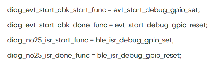

5515 芯片可通过如下方法确认调度是否正常,即isr和 start 有规律的均匀产生
typedef void (*diag_trace_func_t)(void);
extern diag_trace_func_t diag_evt_start_cbk_start_func;
extern diag_trace_func_t diag_evt_start_cbk_done_func;
extern diag_trace_func_t diag_no25_isr_start_func;
extern diag_trace_func_t diag_no25_isr_done_func;
void evt_start_debug_gpio_set();
void evt_start_debug_gpio_reset();
void ble_isr_debug_gpio_set();
void ble_isr_debug_gpio_reset();
diag_evt_start_cbk_start_func = evt_start_debug_gpio_set;
diag_evt_start_cbk_done_func = evt_start_debug_gpio_reset;
diag_no25_isr_start_func = ble_isr_debug_gpio_set;
diag_no25_isr_done_func = ble_isr_debug_gpio_reset;

赋值要放在协议栈初始化后
