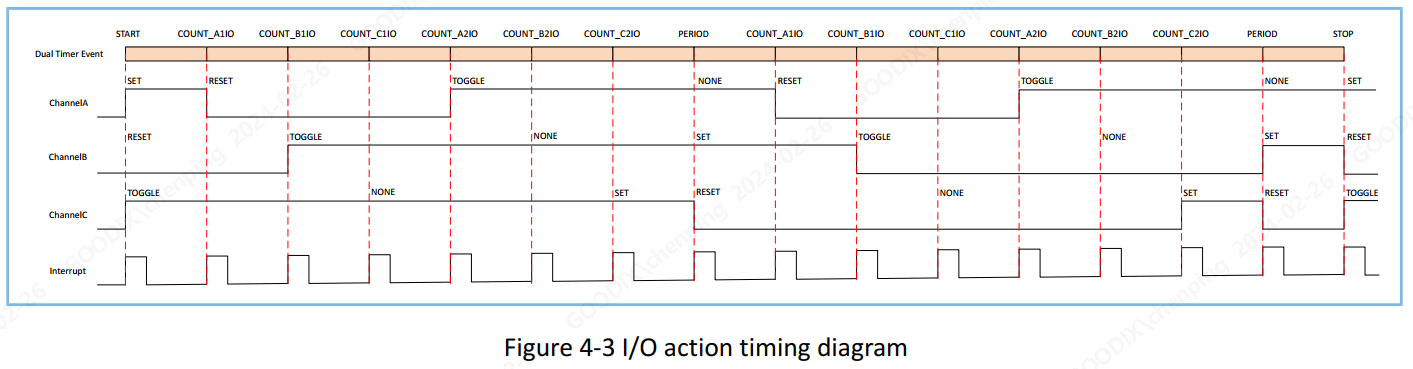

For example, the I/O action timing diagram of I/O control function using dual timer is shown in the figure below.
